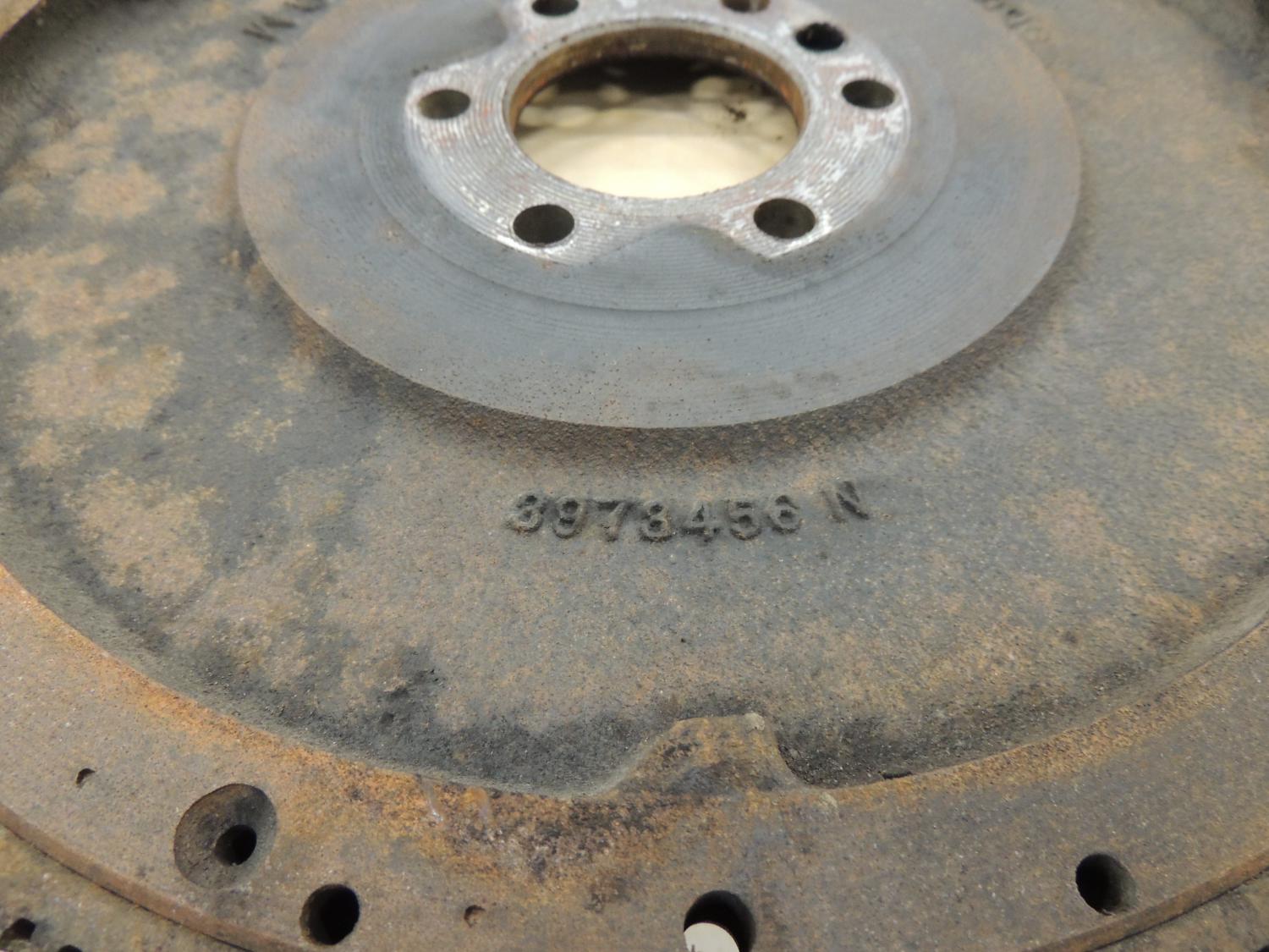

Original nodular iron flywheel. Dated Dec. 69, which about right for my Feb 11 built car.
  #28
Old 04-15-2024, 01:55 AM
Lynn Lynn is offline
Location: Oklahoma
Posts: 7,727
Thanks: 88
Thanked 3,545 Times in 1,497 Posts
Oops. Forgot flywheel pics.

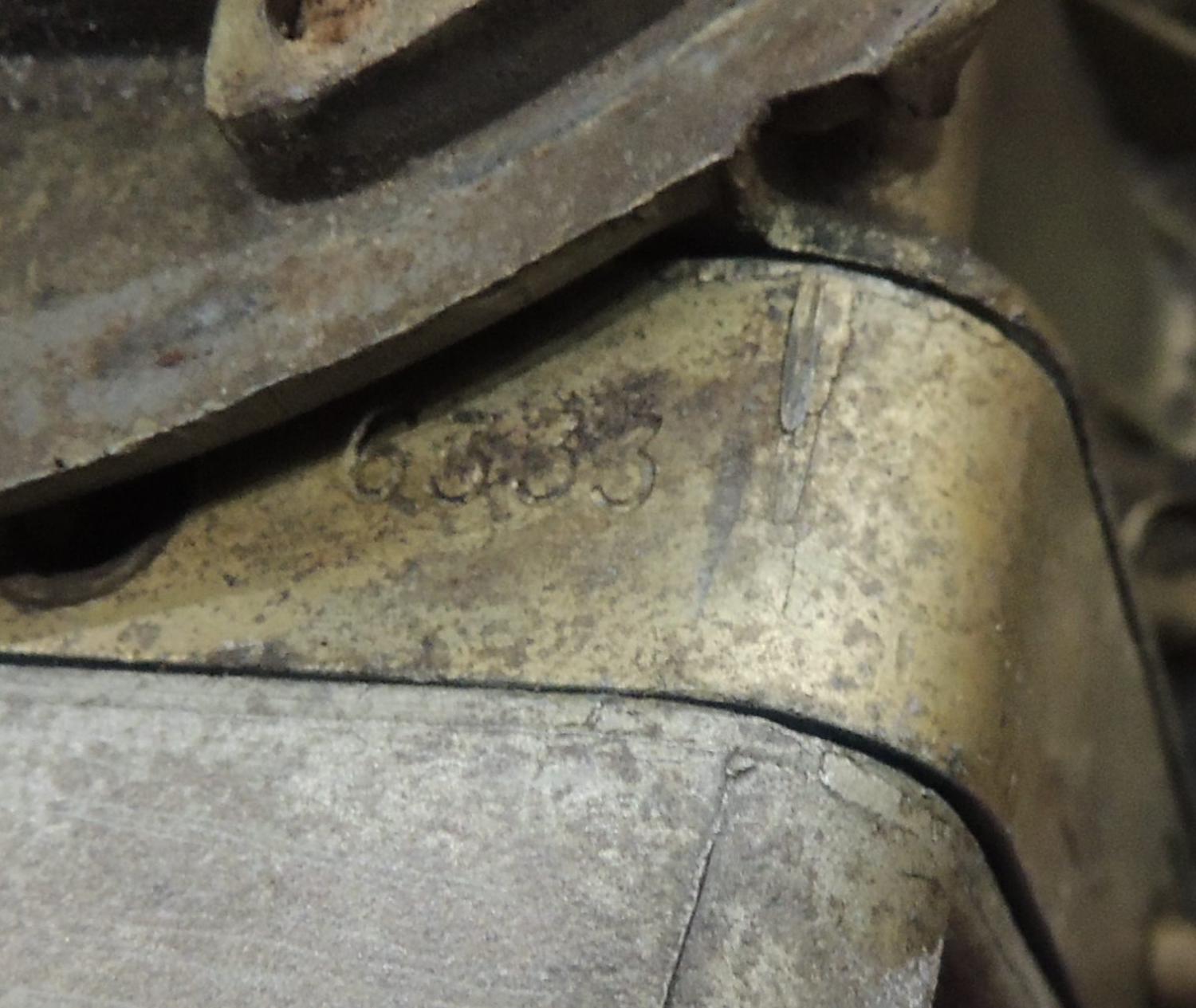

Holley Carb. Apparently, the original was swapped out somewhere along the way.
This one looks pretty grimy, but it ran perfectly. No hesitation; no flat spots.
Has correct metering plates. 6333 & 4519.
As you can see, this one is dated fourth week of May, 1970, so not original to my Feb 11 car.
I was told by a member here that this is actually a very desirable date code. Same carb was used on 1970 Z/28 with manual trans, and on the Yenko Deuce.
I will probably send it off to Eric and have it restored. Will then ask a ridiculous amount of money for it, and hope to parlay that into purchasing a Dec 69 or Jan 70 carb.
