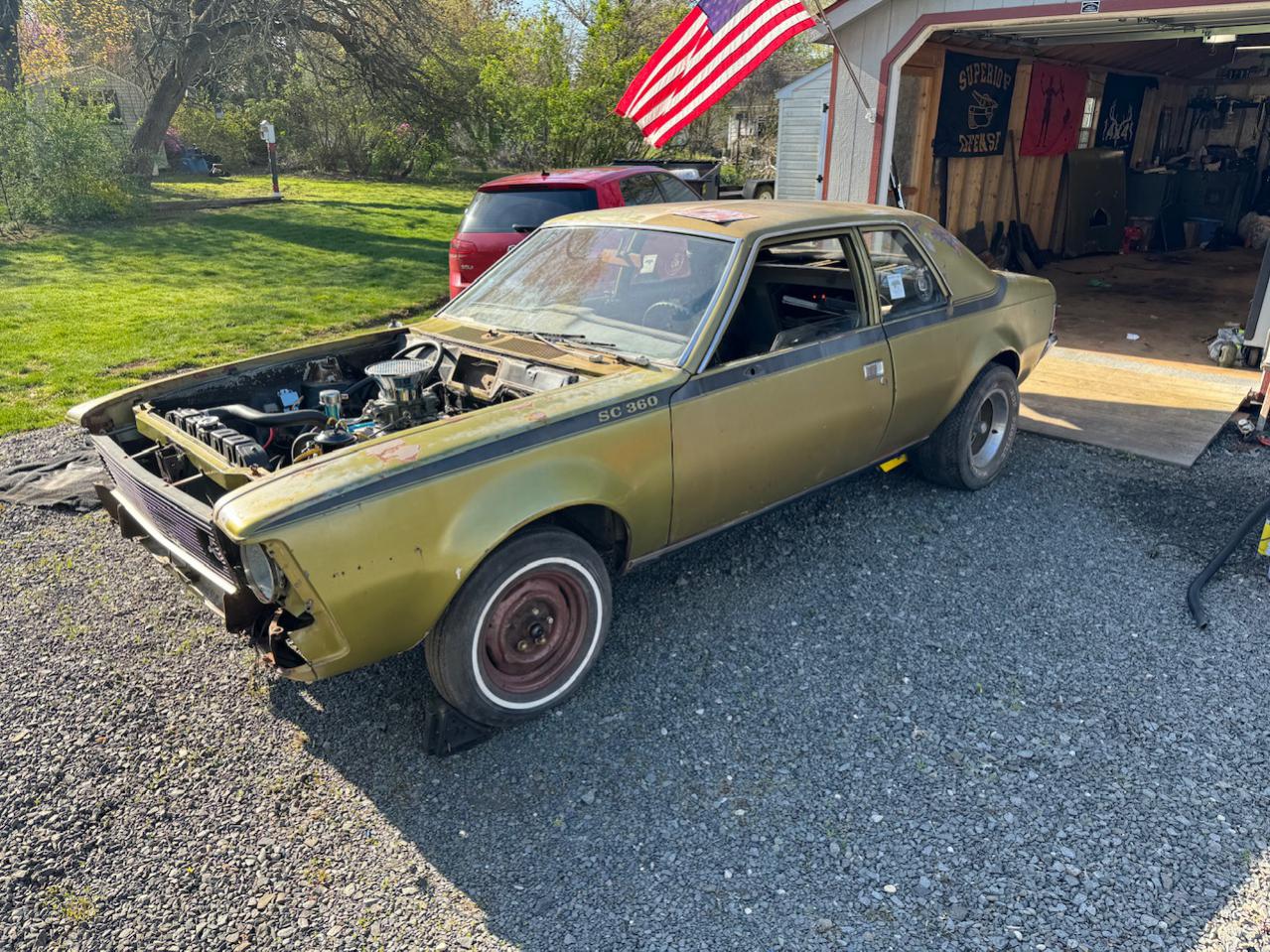

Have a nice sized update today. I’ve been working on stuff but nothing picture worthy. I now have working brakes and my complete fuel system is plumbed from beginning to end.
Started this morning by cleaning out in front of the car and getting it pushed outside. Spent time today getting the interior put together. The carpet isn’t original but was put in the car in the late 70’s. So I decided to keep it. I carpet cleaned it yesterday and got it installed this morning along with the ugly green Javelin seats I picked up.
Next was cleaning the rest of the interior and installing the rear seat. Overall I’m happy with the inside of the car. My dad and I then spent some time cleaning the paint. Or at least starting to. My 1 year old had other plans for us so we gave up on the paint for today.
Overall got quite a bit done. Hopefully my driveshaft is done tomorrow and I can get the trans filled with oil after that and start getting the engine wired up to run.

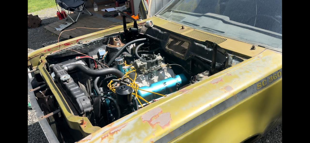

Spent some time yesterday going through wiring on the car and was able to get 12 volts to the coil. Then figured what the hell and threw 5 gallons of 100LL in the tank and filled the bowls and the car fired right up. Broke the cam in and got it to idle around 800.
I had initial timing set around 8-10 degrees before it slipped time backing it into the garage and backfired hard enough to pop the dipstick a foot out of the tube. I’ll have to retime it over the weekend and reset the idle. Otherwise I’m happy.
Took it for a quick ride around the block to make sure it shifts. I need to adjust the clutch a touch but again, overall it works just fine. I’m not sure if I can post a video here. If I can’t I’ll put up a couple of screenshots from the vids.
