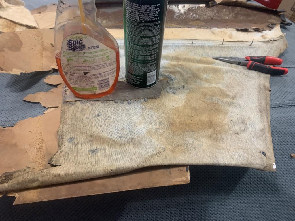

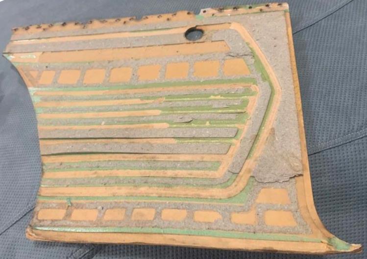

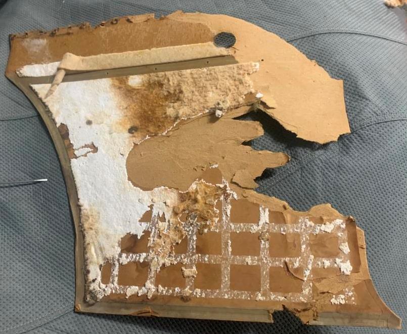

Since I was having no luck locating a good replacement rear panel due to the previous racoon that took up residence in the car while in storage at my parents home. I pulled the vinyl off the board and removed it. I had an old junk 69 panel so I used it for its board. Once I applied new foam I patched (very crudely) the tear that was in the material. Again thanks coon...
UPDATE: - I had a good friend reach out with a set of door and qtr panel covers and I will update that at a later date.
Photo 755 - Original board chewed by coon.
Photo 756 - '69 donor (I knew 69 parts were good for something. )
Photo 757 - foam glued
Photo 758 - Crude vinyl repair

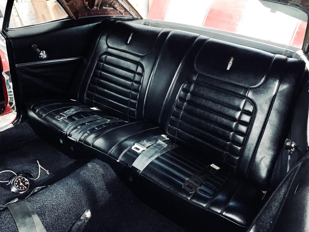

After it had setup I installed it along with the back seat.
Photos 759 - 760 - Back seat and panel now installed. The panel will have to do until I can find a suitable replacement. I'd rather push forward than delay the project. I can always go back and replace it.

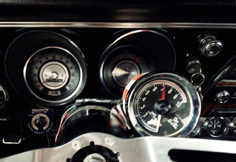

I looked at another tach option from my stash. At some point the car had a column mounted tach as the cup on the column had an indention.
Photos 761 - 762 - Don Garlits Stars and Stripes tach. Oddly enough my father acquired this tach from a fellow member many years ago when he purchased a C10 from him. I've cleaned it up a little and it looks ok.
Found the bulb for the glove box so I installed it and confirmed it was working along with powering up the tach light to make sure it did not need replacing. Also installled glove box and door.
Photo 763 - 764 - Glove box and door with auxiliary light. Also like to add that's an original "born-with" scratch. I'm kidding. Idk when it happened but it was long before me.
Photos 765 - 766 - DG S/S tach lit up with the dash cluster.

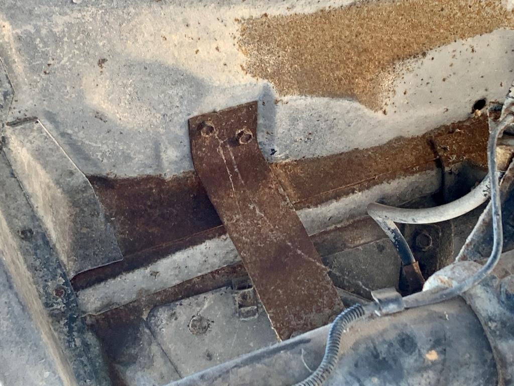

Back on the horse over the weekend. Cleaned up the subframe tails so I can reinstall it. I'll continue the cleaning on the sub once I am ready to work on the front suspension.

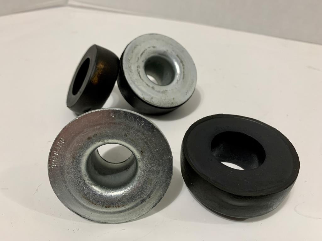

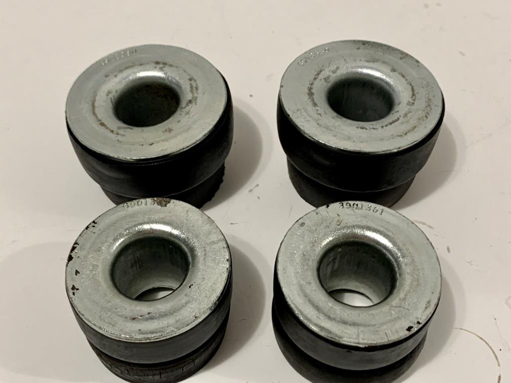

Photos 767 - 769 - Thanks to a good friend Jose (jbtech) I was able to obtain a set of original sub cushions that were taken off an early 68 LOS car.
Photos 770 - 771 - Subframe tails before cleaning up the old spray bomb black.
Photos 772 - 774 - Tails cleaned, then using my da polisher I hit everything with M105 & M205 Mequiars.

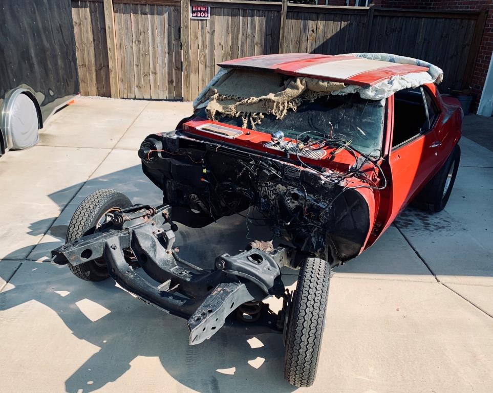

Next I slide the sub back under the body and using my old brass punches as my alignment pins got it all bolted back up.
Photos 775 - 777 - sub bolted up using the pins.

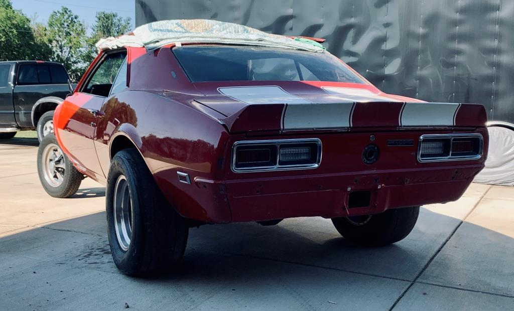

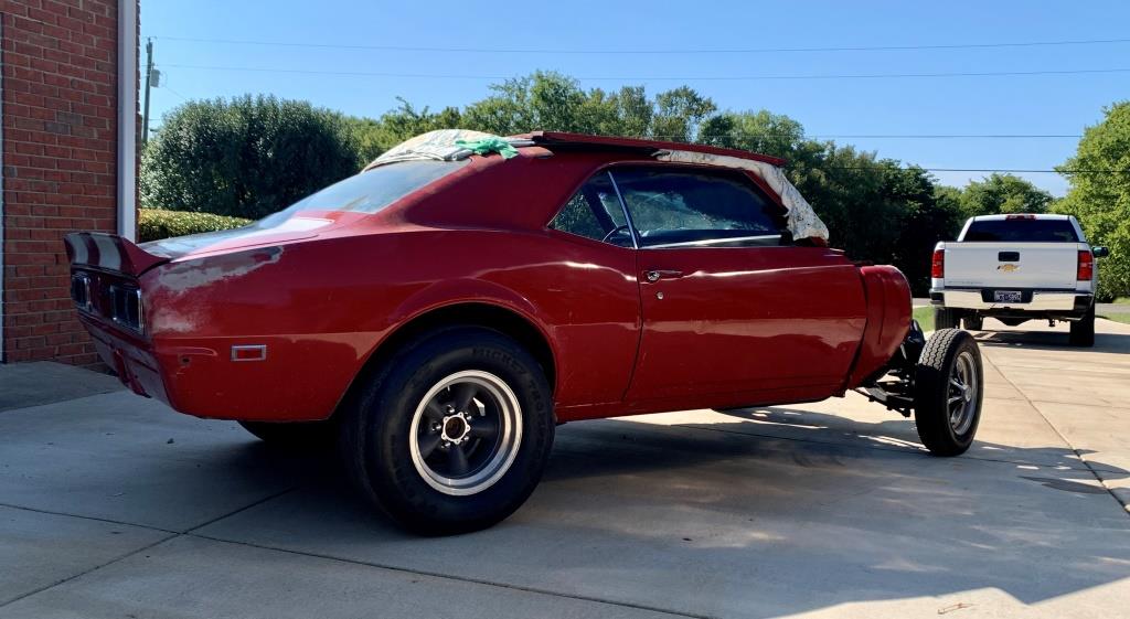

Next I rolled the ole girl out into the sun for the first time in a few years.
Photos 778 - 781 - overalls before knocking the dust off.
