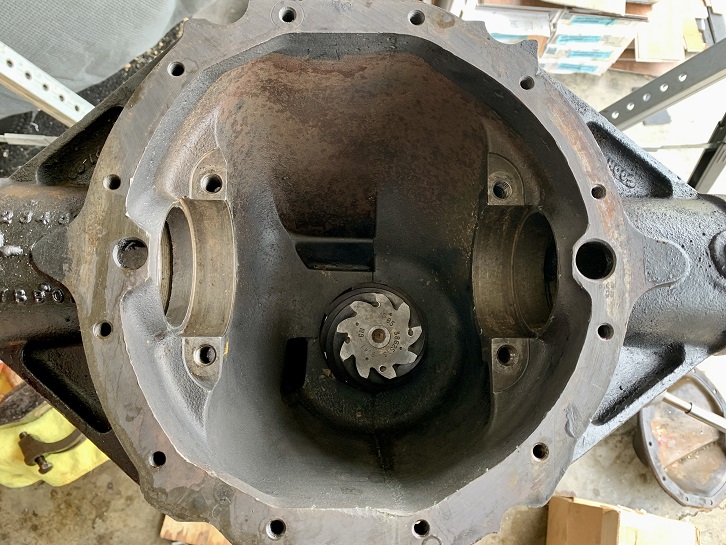

Diff cleaning and preserving is now complete. Installed pinion races and carrier bearings (not pictured and previously axle bearings and seals). Once I get the inner pinion bearing installed I will start the reassembly process. I've decided to go with the solid pinion sleeve and I'll walk through how I set it up etc once the time comes.
Photos 937 - 940 - Diff during the heating and coating of Cosmoline Rust Veto & RPM (Rust Preventative Magic). I heated the differential with a heat gun and applied the mixture with a paint brush and kept heat on it while it cured and leveled out.
Photos 941 - 942 - Center section and the casting date now revealed. C 21 8
Photos 943 - 944 - Perches and their markings of LH and RH

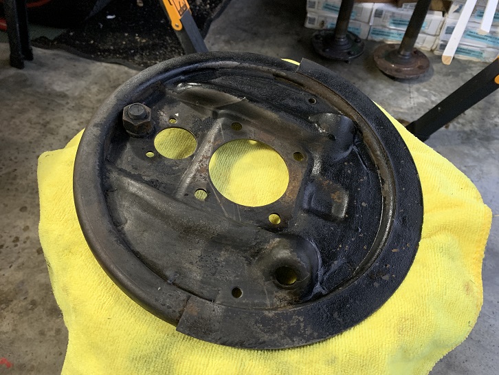

Photos 951 - 952 - Backing plate

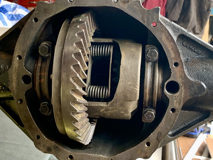

I decided to go with a solid pinion shim for this application. I measured the old crush sleeve and it was 2.283 - 2.278". I added shims to the sleeve to hit right at 2.282" and left the pinion seal out while I attempt the setup. Overall the carrier shims were 0.242" on the left and 0.063, 0.063, 0.098" on right of the carrier looking at the diff. Overall total was 0.476". the final setup was on the left 0.242 & 0.013" and the right side was 0.160, 0.063" for a total of 0.0478". This put the backlash right at 0.006 - 0.007". These are used gears and do not show the same pattern as new gears but this is an acceptable wear pattern (confirmed by a couple of folks that have experience). Pinion shim could have been a little thicker to deepen the pattern engagement but for all I am happy with the look. Worst case once the car is up and running and if there is a whine on decel then I will go back into it.
Photos 957 - 958 - Pinion installed with the correct resistance on the bearings. I've always gone off of feel and it hasn't failed me yet. Note: the carrier shim photos are not the final shims used for the setup. Just ones I tried using to accomplish the correct backlash.
Photos 959 - 960 - Carrier bolted down using a crossing pattern and then using a magnetic base and dial indicator confirmed the backlash was 0.006 - 0.007".
Photos 961 - 962 - gear mesh
Photos 963 - 965 - Pinion seal, "New" aluminum diff cover, vent and yoke.
