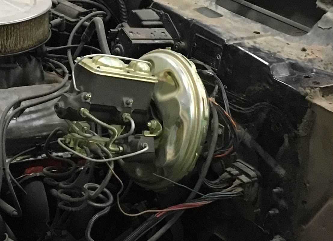

Hello to all,
I am restoring a 1970 Nova SS and would like to know what the correct distribution block,metering and hold off valves are as none came with the car when I got it.
Thank you in advance,

Post Brake Components....
Location of the proportioning valve depends upon build date...when was your car built.??

Hi Wilma,
Build date on the trim tag is 05A.

Post Brake Valve..
That build date puts the valve under the master cylinder...early cars had them on the frame rail under the driver's door.
I can probably send a few photos of the correct set up for your car...let me know.

Yes,please send some photos.
That would be great.

Default 70 Nova Brakes
Found these from my March 70 SS 396 L78 car.

Default Nova Brakes
Name:  Nova Brakes.JPG
One more.

Same as 1970 Camaros, I have ALL these parts..............

Hi,
Gary,thank you for the photos
Chuck,I will be sending you an email.

A big thank you Chuck for supplying me with all the parts that I needed!!
