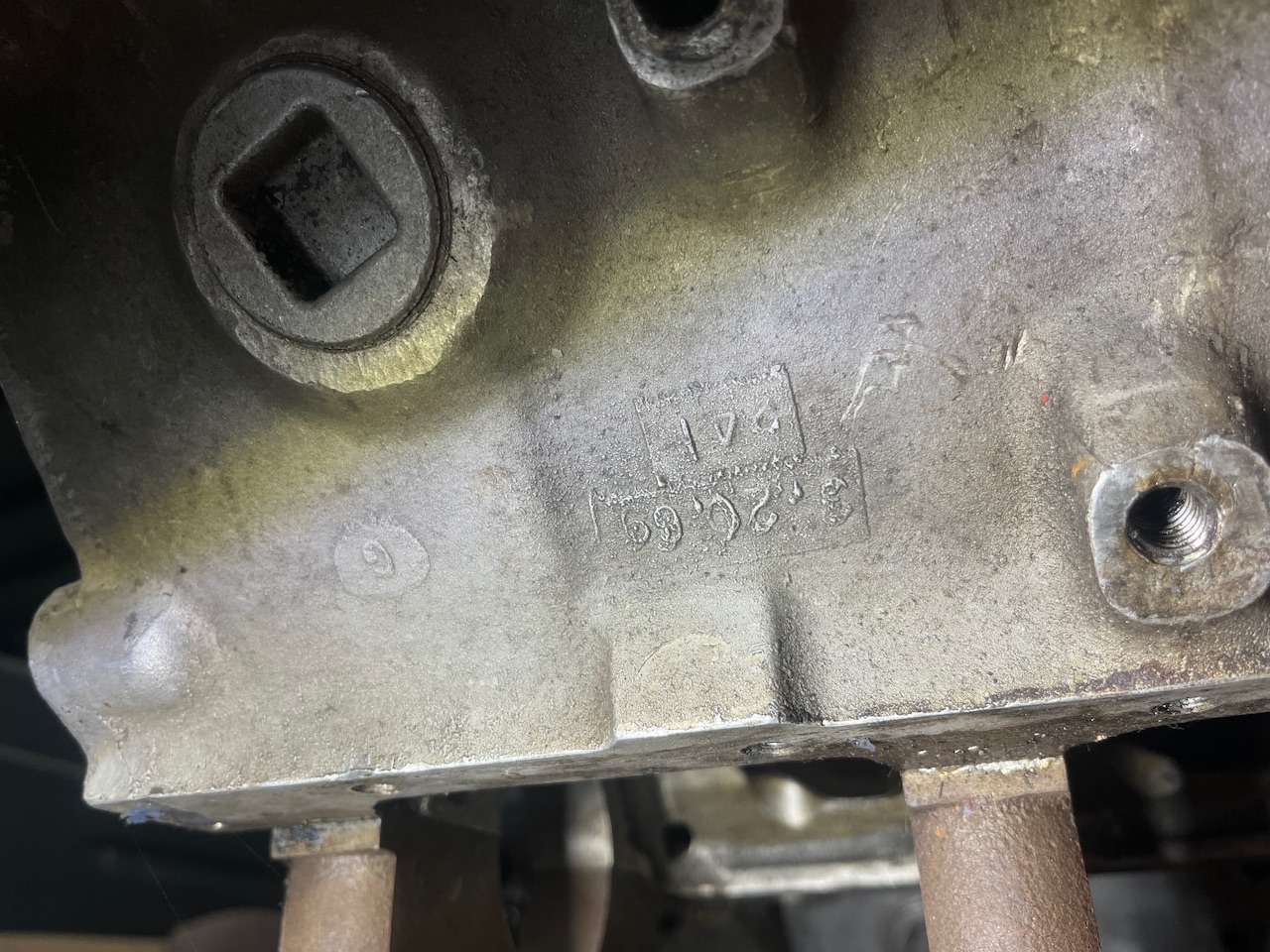

Here is an example of a March and January date I have here. As you can see, the January date, although hard to make out, is the smaller format. The March is the larger format.
Jason

The block in question also does not have the “W” in the snowflake showing it was cast at a different foundry.
Jason
