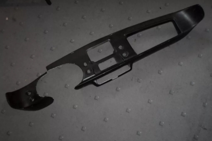

I was able to score a carbon fiber dash molded off of a real 507 dash. It should be here in a few weeks, and this well help fine tune the measurements of the interior based on what I’ve calculated so far. WOOHOO!!! The gauge pod is easily fabricated and I’ve already talked to a place that can make the gauges for me.
I already have a factory Becker Mexico radio, speaker, amp, as well as the throttle, choke, wiper and vent knobs. Moving right along! Time to do a video recap to show how I’ve got to where I’m at since a few BMW aficionados somehow got wind of this project and are pretty intrigued to say the least!
